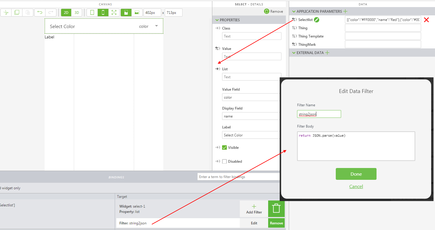

Hi--
This stumped me for a while, too. Here's the general process:
1) Define an application parameter to store the menu contents as a JSON string
2) Bind the app parameter to the List field in your Select widget
3) Add a filter to convert the string to a proper data object using JSON.parse()
4) Enter the JSON for your menu choices in the app parameter
For the JSON data structure, you'll want an array of objects, where each object has the same field(s) specifying the values (and display values, if different). For example, here's a very simple menu:
[{"color":"Red"},{"color":"Green"},{"color":"Blue"}]
For this menu, set both the "Value" and "Display" fields to "color".
If you want the display text to be more descriptive, you can do something like this:
[{"color":"#FF0000","name":"Red"},{"color":"#00FF00","name":"Green"},{"color":"#0000FF","name":"Blue"}]
In this case, set the "Value" field to "color" and the "Display" field to "name". The menu will use the names, but will return the CSS color spec as the selected value.
--Clay

I have now also tried the full infoTable format and a keyed array. Still no luck here. How can i get a dropdown box into my experience with data not from a connected ThingWorx server?
