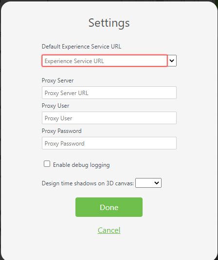

For the commercial usage - customers could use a Experience Service which is installed and configured on the PTC cloud. In this case customer need only to install Studio and could publish on the PTC Cloud experience service.
And how can I load the license module when I got it? Is there any other program needed from the download matrix? Which url to set the Experience Service to the PTC cloud es in Vuforia Studio?
Thanks and best regards,
Patton
Hello Patton,
actually to install Vuforia Studio and to publish to cloud you do not need any extra licenses. you need only to know what is the URL of your PTC cloud experience service and to have valid login account for it. When PTC create a new PTC customer cloud account - in this case the admin , who is responsible / the main point of contact on the customer side , should receive a welcome e-mail which contains the URL of customers Thingsworx and Experience Service Instances on the PTC cloud for commercial and for test/development - means 4 URLs . In this case the customer admin could add other users so they will be able to login  TWX and to use also the Experience Service /dev + commercial. Please, check who is the admin for AR/Vuforia in your company  and ask him/her for the URL  and login account data.
In some cases is possible that the welcome e-mail was not sent or some e-mails filters blocked it.  In this case , please, open a Technical Support Case for AR /Vuforia Studio and request that  PTC will send your account data again.
