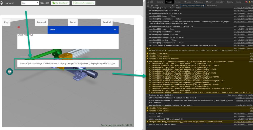

This will write in the text property of the input Text widget only the names of the used states:
[index=0].displayString=STATE-1;[index=1].displayString=STATE-2;[index=2].displayString=STATE-3;[index=3].displayString=STATE-4;[index=4].displayString=STATE-5;[index=5].displayString=STATE-6;[index=6].displayString=STATE-7;[index=7].displayString=STATE-8;[index=8].displayString=High;
You can use now the text property of this widget in your javaScript code

This is similar to the filter definition mentioned above. Here the function will write the stateNames of TestState1-100 to the javascript list myList. You can change this code to add all required filed of the stated definition to your list.
Example when I tested it :
I found there a mistake in the last displayed pictures.
The printings to the debugging console of the last picture is the first print of the test button function which is not so relevant- it contains all states Definitions. The more important print the state definition State1-100 is the same as shown in the picture above
