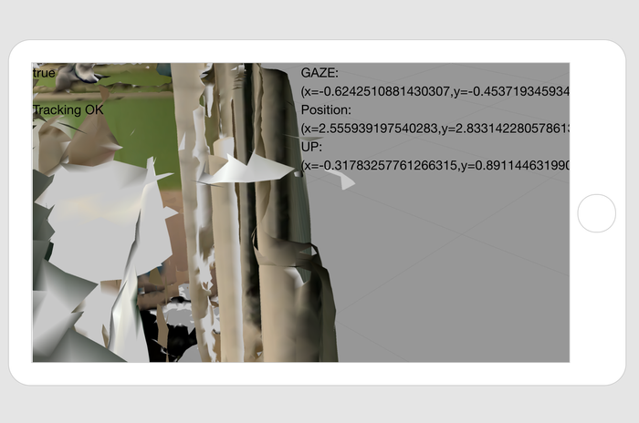

possibly you can activate the tracking event and check the device position, up and  gaze vectors. So you could calculate the vector distance to another object (widget) .Some code like thiis:
$rootScope.$on('tracking', function( tracker,fargs  ) {
   console.warn(tracker);console.warn(fargs);//some info about the arguments

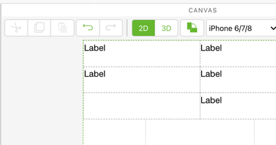

   $scope.setWidgetProp("label-3","text","GAZE:(x="+fargs.gaze[0]+",y="+fargs.gaze[1]+","+fargs.gaze[2]+")");
  $scope.setWidgetProp("label-4","text","Position:(x="+fargs.position[0]+",y="+fargs.position[1]+","+fargs.position[2]+")");
  $scope.setWidgetProp("label-5","text","UP:(x="+fargs.up[0]+",y="+fargs.up[1]+","+fargs.up[2]+")");
$scope.$applyAsync();
Bildschirmfoto 2021-06-16 um 14.23.22.png               Bildschirmfoto 2021-06-16 um 14.24.58.png

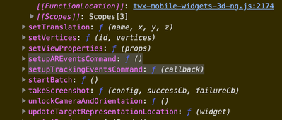

I access related properties via the code below successfully.
$scope.getProps = function(){
  tml3dRenderer.setupTrackingEventsCommand (function(target,eyepos,eyedir,eyeup) {}
