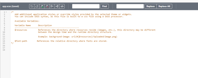

You don't need to edit any file in the project folder. You can just click on the "Styles --> Application" menu in Vuforia Studio.
There you can write CSS code.

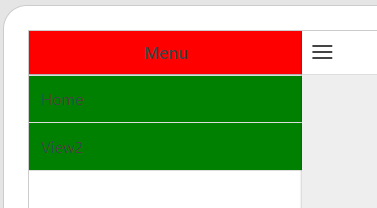

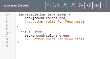

Hi, try to add the following code in the CSS section.
.bar-stable.bar.bar-header {
    //CSS rules for Menu header
.list > .item {
    //CSS rules for Menu items

Try to use only these classes:
The result of my code is this:
Try to add CSS rules to customize your style
