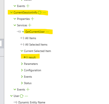

Hy ,
Add a Thing  CurrentSessionInfo     and      service     GetCurrentUser ....
io hope to help you
Giuseppe

Wow that was fast and worked fine. Thank you.
