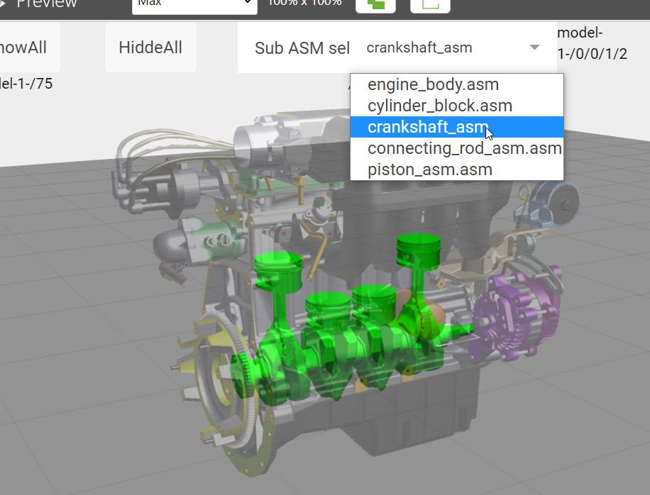

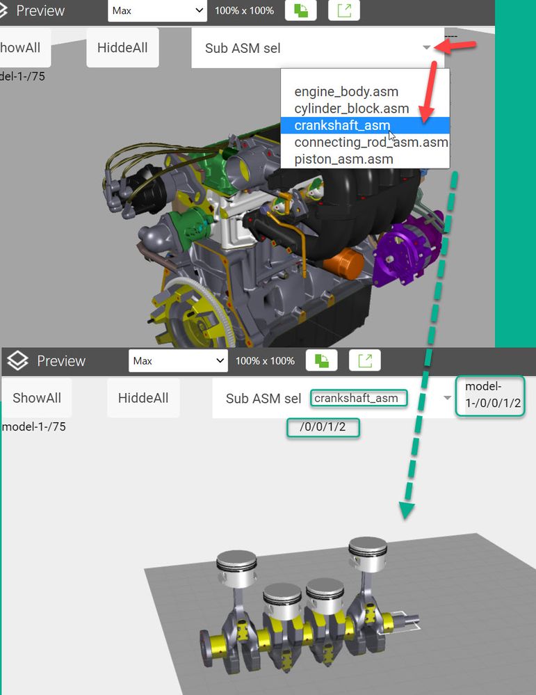

as mentioned in my previous post - checked the functionality /sample project from https://community.ptc.com/t5/Vuforia-Studio/Hide-model-and-isolate-model-item/m-p/797796#M10875 and added a new functionality based on the custom search
So from a list of sub assembly paths (select-1) - when it is selected - then it will hide all components of the assembly and then will search for the components which contains in their idpath the subassembly id path and make them visible. I attached the new version of the project and hope that it helps.
Hello, let me share the solution I found for my use case:
var selected = metadata.getSelected()
for (var i = 0; i < selected.length; i++) {
if (selected[i].startsWith(item)) {
show3DObject('model-1-' + selected[i]);
} else {
hide3DObject('model-1-' + selected[i]);
where "item" is the component part id path
