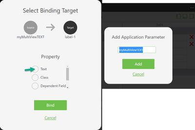

so back to your example and the app parameter
you can create a binding form this app parameter to different widget properties.
Then when you change the parameter value this will change all property in the active view which are associated with this app parameter.  When another view is loaded and it use a binding to this parameter this should update the value , when there is existing  binding form parameter to the property.
Then to sett all values having binding from this parameter you should do some thing like this:
$scope.test = function(){
//$scope.app.view['Home'].wdg['label-1']['text'] = "test";
//instead of this above set the app parameter which has binding to
// text property of label-1 widget
$scope.app.params.myMultiViewTEXT="test";
$scope.app.params['myMultiViewTEXT']="test";
// or another valid usage, syntax which will accept space in paramName
//e.g bla bla  $scope.app.params['bla bla']="test";
//$scope.app.params.bla bla="test";
// will not work in this case
