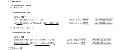

i have installed following bundle. vuforia studio 9.20.11 and vuforia experience server 9.20

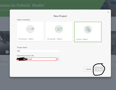

Now while creating project  experience url was not taking by default , then i have added manually there but still this create button is not enabled here.
can anyone help me , how to proceed in this

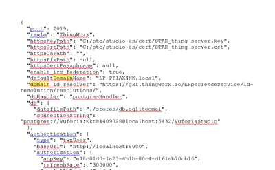

The format of Experience Service URL should be something like:
http://localhost:2019
Otherwise, the "Create" button will not be active.
To find the URL of your Experience Service, you can check the value setting of “defaultDomainName and port in configuration.json under your Experience Service Installation folder <Vuforia ES Installation>.
first of all after clicking open button of Vuforia studio
Url is opened is this http://localhost:3000/home
and as u said in configuration.json file i m seeing url is different
Can you please help me to proceed in this?
After you start Vuforia Studio, you can author experience project vial  http://localhost:3000/home in Chrome or Edge.
If Vuforia Studio is on the same machine as Vuforia Experience Service (VES), you can set the URL of VES as below:
http(s)://localhost:2019
If "nossl" is set to true in configuration.json, here the protocol should be http, otherwise, it is https.
If Vuforia Studio is on a different machine, you can set the URL of VES as below:
http(s)://<IP address of the machine LP-PFIAX4nk>:2019
then, after you enter the project name and URL of VES, the Create button should become active and you will be able to create experiences.
now i can create the new project with create button enabled. Thanks. @Jimwang

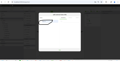

can you please help me to do the  integration of vuforia studio with thingworx instance?
Vuforia studio , experience server and thingworx server all are on same system.
i tried with helpcentre but failed to do so.

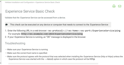

https://support.ptc.com/help/vuforia/es_install/en/?_gl=1*57vq0d*_gcl_au*NDI0ODQyMTkwLjE3MTk4MTI1Mzk.*_ga*MjM2NjA3MzM1LjE3MTE0NDY4MTg.*_ga_7NMP2MSYPM*MTcyNTMzNDg1MC40OC4xLjE3MjUzMzY1NzEuMjcuMC4w#page/ES_Install_Help_Center%2FValidateESBasicCheck.html%23
If you don't select the checkbox to allow public Experiences to access ThingWorx data during the installation of Vuforia Experience Service, you need to configure the User access control firstly refer to the below document:
Experience Service Help (ptc.com)
my question is
why i m not able to see thingworx entities in external data of vuforia studio?
though VES and thingworx on same machine
If you go to Project > Configuration > Info menu, then click Validate button to validate Experience Service, is it successful?
