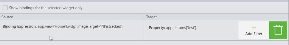

another option is to check the istracked property of the image target widget e.g. : app.view['Home'].wdg['imageTarget-1']['istracked']. You can e.g. create a binding to parameter:
and the use $watch construct to check if there is change for the  istracked value:
$scope.$watch('app.params.test', function(val)
 if( val==true) //tracked
//play this code first time and set a global variable to
//ignorre further changes later
Means that you can use such sample event to call a function . Because you can lose the tracking and start it later again - in this case you have to pay attention to start only one time--e.g. when the function is started first time you can set a global variable and  always check when tracking was acquired if the variable was already set.
