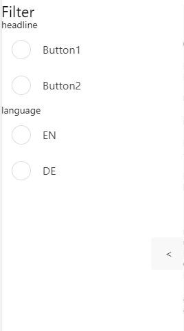

$scope.HideSidebar = function () {
sidebarswitch=!sidebarswitch;
$scope.view.wdg['gridLayout-2'].visible=sidebarswitch;

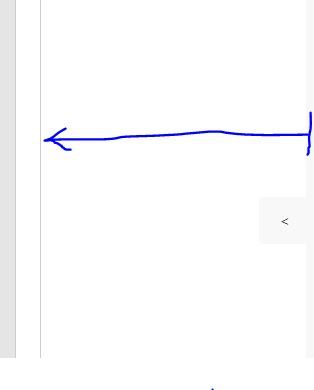

This is, what the sidebar looks like when gridlayout-2 is invisible, I would like to have the white area disappear and the "< " button to move to the very left.

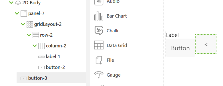

It would be helpful to see your item tree or hierarchy  as well. Also. are you using css? Then you probably have to change some properties there too. I got this working with a hierarchy like this without css:

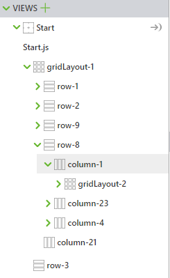

This is my hierachy:

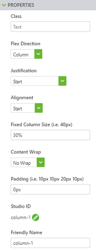

gridLayout-2 from column-1 is mad invisible. The thing is, that column-1 is still there as white space. I would change the with of the column by code, but I can't find a way to access it.
I us some css, but not for the columns or the grids right now.

You can try to put your gridLayout in a Panel and hide the Panel instead.
