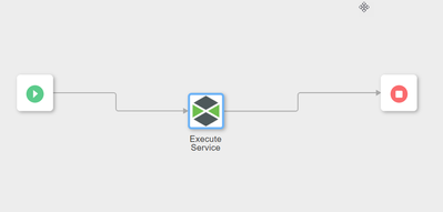

Hello, I'm using thingworx flow to get some pvz files from windchill ad upload them into vuforia experience service repository. The process works, but using these pvz into vuforia studio seems to not load the metadata automatically (as instead using thingworx repository does). How to solve this issue?
Can I extract the metadata of the gathered pvz and upload it as a separate file? How to do this into thingworx flow?
Many thanks

There is an external extension https://github.com/mvonhasselbach/CreoViewRWExtension that will create the meta data. I have not used this with Thingworx flow. The approach I took was Thingworx OData and wrapper services which work well. The link is to a Thingworx extension you will need to install and create a service
logger.debug("Entering GetJSONFromCreoViewFile ");
var params = {
FileRepository: RepoName /* THINGNAME */,
ReturnedProperties: (returnedProps || undefined) /* STRING */,
CreoViewFile: pvzFilePath /* STRING */,
JSONFormat: format /* STRING */
// result: JSON
var result = Resources["CreoViewRWHelper"].GetJSONFromCreoViewFile(params);
In my case I place the pvz and the meta.json in the same Thingworx Repo and provide the url to the pvz source. The meta.json file needs to be in the same relative location
I used a GUID for the pvz and meta,json file names as they need to be the same for example xxxx,pvz xxxx.metadata.json
Does this help
