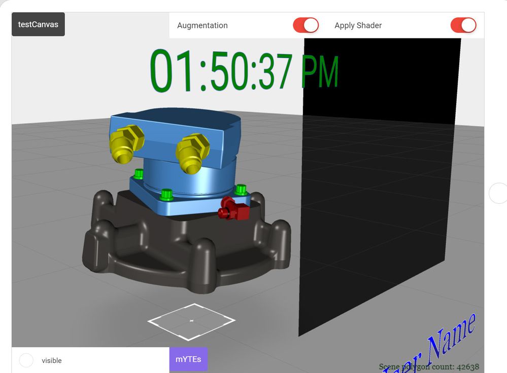

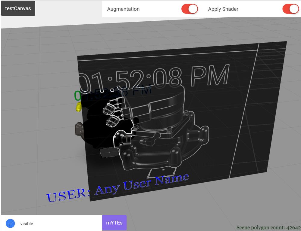

So regarding possible workaround - we can take a picture (or possibly 2 pictures - one time without augmentation and one time without augmentation) and sent to server - where we have a picture analyzing system where you check that.
For example you can use some kind of soebel filter
to have only edge display  (grdient x,y) to get something like this:
and then you can use some image recognition network which is trained to recongize the hole geometry . Possibly you can compare the 2 pictures (with/wuthout agumentation) both as edge geometry) to find where is a difference.

As per the provided workaround, the two images to be compared should be captured from the same location, which may not always be possible due to minor hand movements.
Additionally, performing image processing on the server to detect edges is time-consuming, as we want to identify faults within the experience promptly.
If the model edges and CAD edges become visible in Vuforia Studio, we can identify defects simply by turning the respective edges on and off simultaneously. We kindly request that you keep us informed about the status of this enhancement request in the future.
