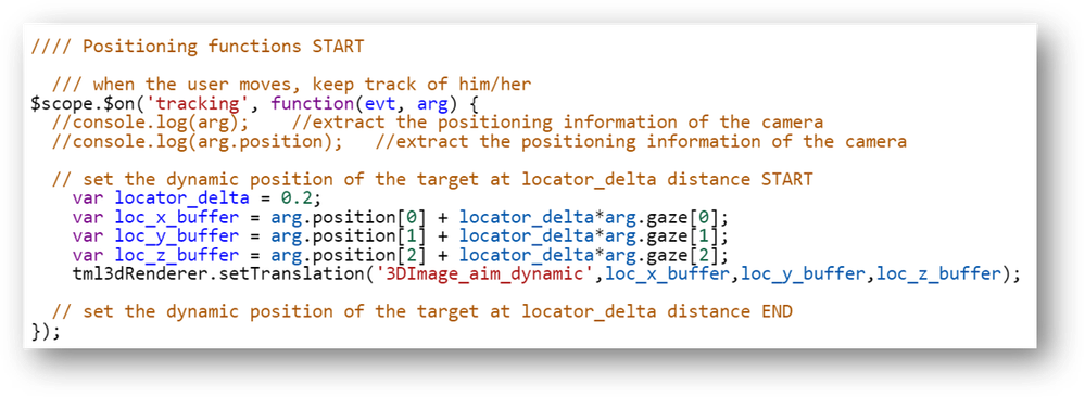

We have another workaround: Basic principle of my/this workaround: Dynamically Extracting the camera - and calculating the ‘Target Crosshair’- Position  --->   $scope.$on(‘tracking’, function(evt, arg) Picture1.png
  • At any moment in time XYZ-position and orientation of the device camera relative to Experience-origin is extracted
    The blue crosshair image is constantly calculated to float (billboarded) at 20cm distance in front of the camera

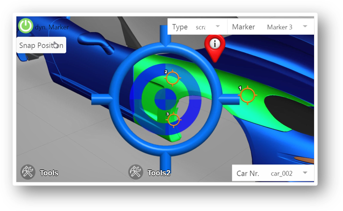

    The constant re-calculating of positioning needed for this method is a performance/battery-life killerPicture2.png
  • Example picture is from PTC developer ,who reported the issue for a large ptc customer- therefore I could not provide here further details
