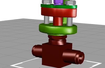

Hi, I just had some issues with getting an app parameter to change the color of a model item to work. Eventually I found out there are some problems with the alpha channel.
I'm using Vuforia Studio 8.3.5.3961 and in the preview it only displays colors fully opaque, even when I set the alpha channel to 0. It's simply ignored, but on my Iphone 5s IOS 12.1(16B92) in Vuforia View  8.3.50, it doesn't display any color when the alpha channel is not set to 1. Unfortunately I cannot test this on another device.
Can anyone reproduce this issue on her/his device? And are there any known issues/bugs, that can cause this?
Thanks in advance for any help.

so could you give ,please, an example how did you set the value? Directly via the property or in inside the javascript?
example:
... via javascript calling the script like :
$scope.setWidgetProp("modelItem-1", "color",  "rgba(128,0,0, 0.3)");
So on the preview it seems that no transparancy is shown - means the transp. is ignored
So  tried also
$scope.setWidgetProp("modelItem-1", "color",  "rgba(128,0,0,0)"); //brown
and $scope.setWidgetProp("modelItem-1", "color",  "rgba(128,0,0,1)");
but the same result in preview as shown in the picuture above.
So tested now on devices -> on IOS and  Android
On android Galaxy S9+ the transperancy was working fine -> so the call
the modelitem-1 is displayed with the correct value of transparency
I tested the same code on IOS  but it was not working. Means it did not display transparency but also the color was not set.
So with  furter tests I found that on IOS seems to work only if the value is transp is 0 or 1
so the call
will be displayed correctly in brown color
and the call
will make the modelitem invisible!

Yeah @RolandRaytchev has it. The alpha channel seems to be ignored and you have to change the opacity value. It makes sense that the opacity value is THE control for modelItem transparency as you need to set that independent of color. The real question is why Studio uses rgba instead of just rgb. Seems like the A is unused.
Hi, thanks for the response. That's what I suspected. I was just wondering if it's an issue with my device or if I did anything wrong. I came to the same result and also wondering why rgba is used instead of rgb.
