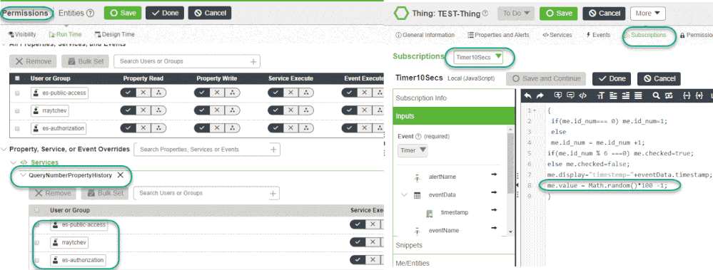

So I tested to verify this behavior on a thing from a cloud instance  e.g. TEST-Thing with a number property 'value' /the name of the property is here 'value'/ defined as shown below in the picture:
There the property 'value' is defined as number and logged.  Via subscription to 10 seconds timer I generated a value stream:
Also to be able to access the Thing and the service QueryNumberPropertyHistrory() form Vuforia Studio I set the proper permissions.
In Studio I added the thing and the service as external data:
Here the query will request the last 25 values of the Thing property "value"
This is also set in the Time Series Chart as y-axis field - the x -axis is the timestemp of the value stream
the following   bindings:
1.) all Items of the QueryNumberPropertyHistrory() service to the Time Series Chart data.
2.)  Service Invoke complete Event to the Time Series Update service.
This was working fine . e.g. in preview mode:
