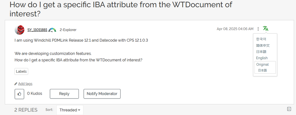

対象のWTDocumentから特定のIBA属性を取得する方法を教えてください。
I am using Windchill PDMLink Release 12.1 and Datecode with CPS 12.1.0.3
カスタマイズ機能を開発しています。

a portion of your text s not visible in english language. can you also put the question in english ?
Hi @aman.somgade,
Please make sure to use the translation option we have available. It will translate the whole text, and title, in English.
Catalina
PTC Community Moderator
PTC
Thanks for the info. I will use this feature going ahead.
