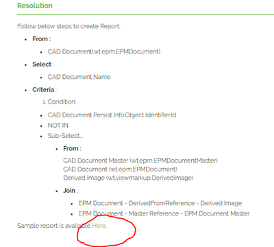

is it possible to generate a report that identifies, starting from a code, all those 3D and 2D documents that do not have a publication in (.pdf, .dxf, .step)?

I saw the solution .. only I'm not familiar with SQL query and I wouldn't know how to create it and where to insert it ...

can you help me find all the tables and join for my search?
Marco_Tosin
(To:AR)
Have you taken a look at the article?
It is all written down and, at the end, there is even a ready-made example report.
