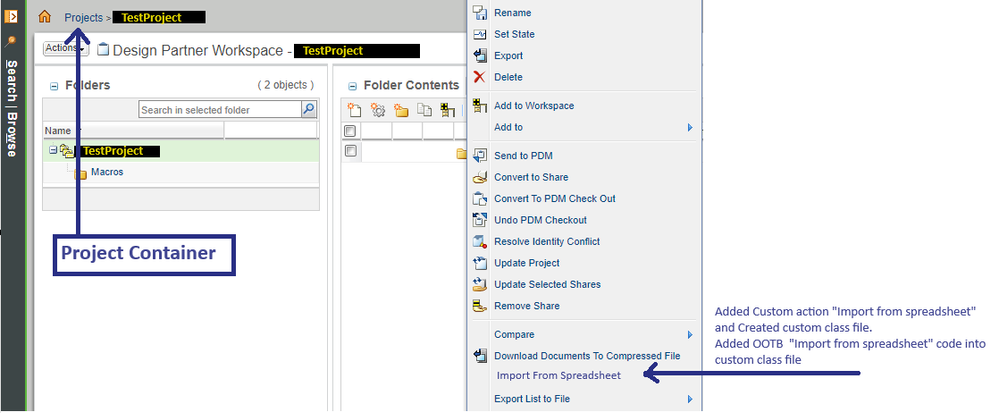

Hello @HelesicPetr
I want "Import from spreadsheet" option in Project container.
Currently this functionality is limited to Product and Library.
If we can't extend existing "Import from spreadsheet" functionality to project container.
Then we need to create custom action with Validator class so that the custom action will be visible only in Project container.
And then need to create class file with help of that we import spreadsheet within Project container.
So for that I need API or code which, I can use in my class file logic.

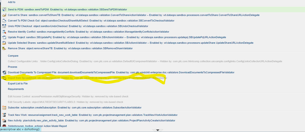

Hi @HelesicPetr,
Sorry But, I am not aware of it. where I can find OOTB validator.
Hi @HelesicPetr@Hari_Vara & @Hari_Varadh
If I run jcaDebug in Project container, I can see Import from spreadsheet option which is grayed out(see attached screenshot).
Question : Import from spreadsheet is grayed out in Project container, Is it due to ACL or OOTB validator?
I think its the OOTB behaviour for Projects.
What is your use case?
Cheers
Hari
HelesicPetr
(To:V_B_THAKARE)

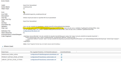

@V_B_THAKARE
OOTB validator checks the ACL.
So it is based on validator.
Also there are many validators for that function.
PetrH
Hi @HelesicPetr & @Hari_Vara ,
1)Created custom action "Import from Spreadsheet".
<objecttype class="wt.part.WTPart" name="Spreadsheet">
<action name="ImportfromSpreadsheet" checkaccess="true" uicomponent="IMPORT_FROM_EXCEL">
<label>Import From Spreadsheet </label>
<command url="/netmarkets/jsp/ixb/importer/import.jsp" class="ext.com.XXX.ImportfromSpreadsheet.ImportFormProcessor" method="execute" windowType="popup"/>
</action>
</objecttype>
2)Created Java file and added OOTB code of "Import from Spreadsheet" into the Java file and just commented out
//if (!(var1.getActionOid().isA(PDMLinkProduct.class) | var1.getActionOid().isA(WTLibrary.class))) {
3)Now my custom action is visible in Project container.

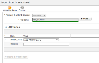

4)Whenever I click on my custom action "Import from Spreadsheet" then after uploading file, Validate spreadsheet option is not visible for me.
5)Also added below entry into xconf file
<Service context="default" name="com.ptc.windchill.ixb.importer.jca.validator.ImportFromSpreadsheetActionValidator" targetFile="codebase/service.properties">
<Option serviceClass="ext.com.XXX.ImportfromSpreadsheet.ImportFormProcessor"
selector="ImportfromSpreadsheet"
requestor="null"
cardinality="duplicate"/>
</Service>
Any idea why it is happening.
HelesicPetr
(To:V_B_THAKARE)
Hi @V_B_THAKARE
Because there is a validation if the wizard is correct one or something else that OOTB works but it does not work for your custom method.
As I said, In this situation It is easier to create own function then bending the OOTB function.
PetrH
