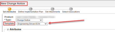

Does anybody know the API to get the Template a Change Notice was crated from?

It looks like you can simply use
wt.change2.WTChangeOrder2 ecn;
wt.enterprise.TemplateInfo temp = ecn.getTemplate();

use this method in your validator
public static WTReference getChangeTemplatePickerReference(FormDataHolder paramFormDataHolder)
throws WTException
logger.debug("getChangeTemplatePickerReference starts");
if (paramFormDataHolder == null) {
return null;
Map localMap = paramFormDataHolder.getComboBox();
if (localMap != null)
List localList = (List)localMap.get("ChangeObjectTemplatePicker");
logger.debug("localList:"+localList);
if (localList != null)
String str = (String)localList.get(0);
NmOid localNmOid = NmOid.newNmOid(str);
logger.debug("localNmOid:"+localNmOid);
return localNmOid != null ? localNmOid.getWtRef() : null;
logger.debug("getChangeTemplatePickerReference ends");
return null;
WTReference changeTemplateReference = getChangeTemplatePickerReference(validationCriteria);
WTChangeOrder2 ecn = (WTChangeOrder2)changeTemplateReference.getObject();
logger.debug("Change Template Name "+ecn.getName());
above line will give you the ECN Template name, carefully type cast, code is just for reference
