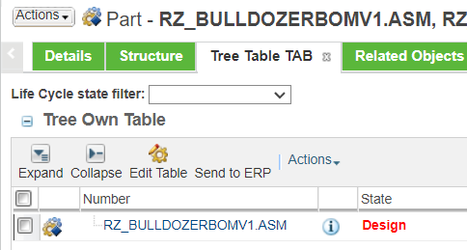

I just add a example
A custom table in custom tab should shows tree based on Structure filter, but I can not find a way how to get the settings of actual filter settings in the TreeDataHandler or TableBuilder.
as a workaround I use an own lifecycle filter but I would like to know to get the structure filter.

Hi, did you ever find a solution, I need to get the config spec from the user session for attribute roll up in configurable structures
Hi @khimani_mohiki
No. The solution does not exist.
The point is that the information is just in the explorer, and there is not any known api to get this information.
You have to use some js functions but it is hardcoded and the effort to get it is too time consuming.
.So you can just use saved filters...
Instead of getting the filter I created wizard, where the user has to set a filter created by me in own UI and based on the users setting I work with own table structure.
