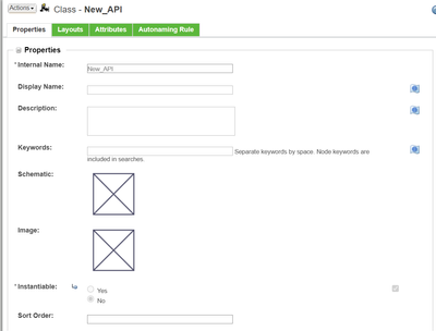

API to update classification node Display name and description through API.
prasad_RR
I am trying to update display name and Description of classification node throgh API.
Please suggest possible ways.

we have a list of 400+ nodes which need to be created .
I have written a code which is able to create all node by reading excel in particular format. same is  shown in above screenshot .But struggling to find a api to update displayname and description.

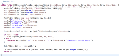

I tried multiple APIS like below but its not updating:
TypeDefinitionReadView nodeView = TypeDefinitionServiceHelper.service.getTypeDefView(AttributeTemplateFlavor.LWCSTRUCT, "com.ptc.csm.default_clf_namespace", name);
String str3 = nodeView.getName();
TypeDefinitionNodeView typeDefinitionNodeView = new TypeDefinitionNodeView(str3, lwcStructEnumAttTemplate.getPersistInfo().getObjectIdentifier());
typeDefinitionNodeView.setDisplayName("TestDisplay");
typeDefinitionNodeView.setDescription("TestDescription");*/

I previously worked on the development of this feature, and there is API support for creating and updating node attributes. I don't check the community frequently.
