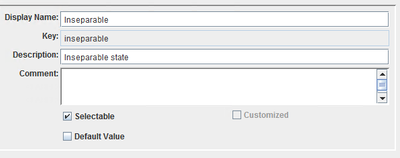

I done as you told me.
I deselect the parameter "Inseparable" (no delete) and I save teh file wt.part.PartTypeRB.RB.ser
But I've a doubt regarding what I need to do after to save the file --> point 7 documentation CS366297.

Just open Windchill shell command line and run
ant -f codebase/MakeJar.xml
I do not use the  custUpdate....
then continue to next point

Thanks again, SOLVED 🙂
