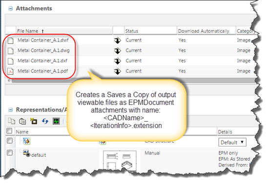

Hi All,
Trying to achieve attaching published files to go as attachments on WTPart.
Got some info need to use after loader method.
Any inputs on using custom Java file for same.
Thanks in advance.
Regards.
HelesicPetr
(To:DKWc)
2 REPLIES 2
ScottMorris
(To:DKWc)
HelesicPetr
(To:DKWc)
Hi @DKWc
Read following article, there is sample code and you can set a config as you need.
CS216668 - An example Afterloader hook method to add the Windchill
CS348848 - How to automatically create a Copy of Output
PetrH
