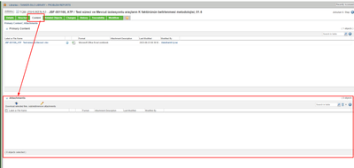

I need to pull the attachment table from the content page into the task.
I want to add a file from the task and the file we loaded from the task should appear in the attachment table on the content page.

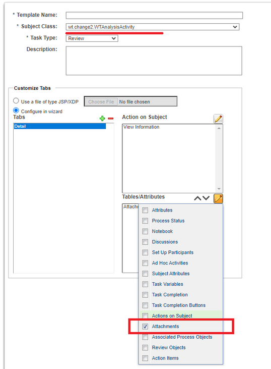

You can try to use Native Form Template where you can define what should be shown
Attachment Table is possible to add there

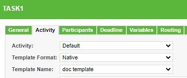

Then just define the task form in the Workflow task where this template should be used.

I am editing a task page with jsp for users.
It will download the excel file that users need to edit from the task sheet and then upload the excel file they have edited from the task to the system from the "Attachments" table.
I have the users download the excel file but I cannot show the "Attachments" table on the task screen.

As I mentioned earlier the Attachment Table is possible to add to the task page by Native Form Template

The attachment table in task will depend on the attachment table in the content page.
The excel file we loaded from the task should appear on the content page.

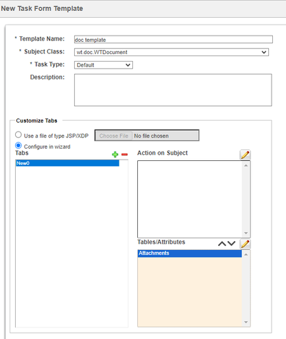

So try what I've advised you
Task Form Template
