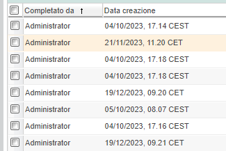

I have been asked to return a name value instead of an email address when in a report that collects who completed a task.
Currently I use "Work Item.Completed By" but this returns who completed the task with the user's email address instead of their full name. Is there another attribute I can use that returns the full name instead of the email address?
Or should I use a convert approach and if so how can that be done?
TIA!

Thanks for your replay @Rocket_Max
Can you show me how to collect this value in the query builder for report templates?
My guess is that the attribute you selected is correct but not the value you are using to fill it.
This is an example of what I see in my system for some tasks completed by wcadmin
Marco
You can try this:
Then get User.Full Name
@mariaSutton
You can use “Java Method” functionality to do this.
Pass completed by to a method that finds the WTUser based on username and return the user’s full name (or whatever you want).
