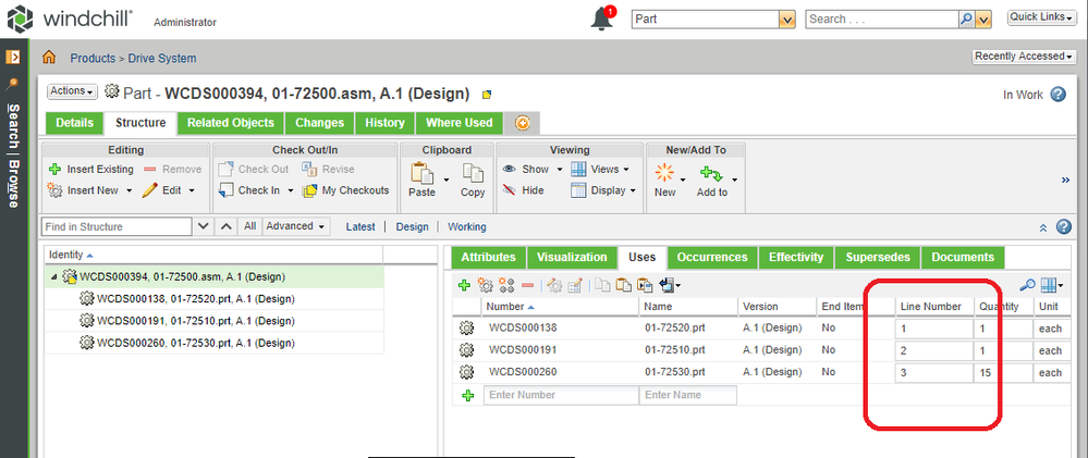

Guys, I created an action in the WTPart action menu that will do it.
I wrote the tool such that it runs only if the WTPart is checked out by the user and it is run from the Working Copy's page. If the tool is run from a non-working copy a window tells the user they need to run it from the working copy.
So, let's say you start of with no line numbers or there are some missing line numbers or whatever.
First checkout the WTPart.
Then select the *Auto Line Number Structure option.
Then refresh the page.
As this is just an example, I incremented the Line Numbers by 1 but that could be whatever you want.
In this example I entered one line number just to do the checkout.
After running utility and refreshing page.
Seems to work well and can certainly do multi-level structures as well.
