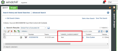

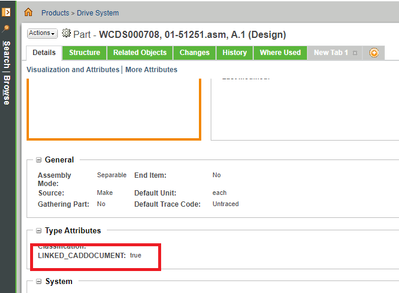

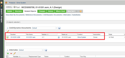

Here's a WTPart that's linked to a CAD Doc.  The Part uses a Calculated attribute LINKED_CADDOCUMENT
And here's the calculated attribute.
Search view of the same part.
