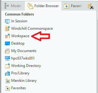

Good morning, in the second tab I'm not able to add a site of my preference follows as this my config if you can guide me.
TomU
(To:MS_Santos)
I wouldn't point the web browser home page to Windchill.  You will get that automatically by just clicking on the 'Workspace' button from the folders list.  Put whatever other custom web page you want into the web_browser_homepage config option.
