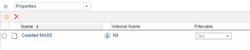

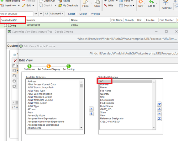

Hi @DKWc
Just example in my case >
N5 is internal name
Courted MASS display name
In WTPart structure the internal name is shown just in the view wizard, but I believe in some cases the table shows also the internal names instead of display name.
PetrH
