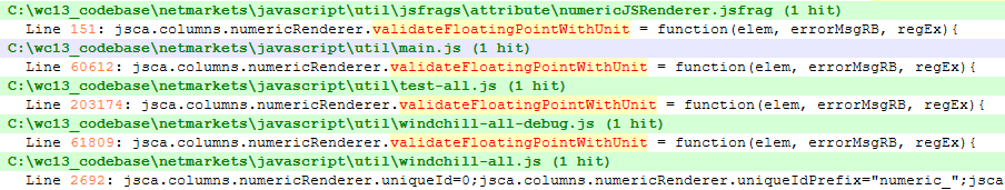

I started poking in to see how this could be done. I noticed that attributes with real numbers with units have a JS validation script associated onBlur. The function is "jsca.columns.numericRenderer.validateFloatingPointWithUnit" but surprisingly, this function is defined in 5 different locations in the codebase. Not sure which one is the one called when the attribute entry is validated but it should not be too hard to narrow that down.
