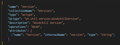

I attempted to create one REST service and tested it using Postman, but I encountered an error. The error message stated :
"Failed to get the search results using Windchill search service: Info resource not found for wt.util.version.WindchillVersion."
This indicates that the REST service was unable to locate the necessary Windchill version resource, causing the operation to fail.

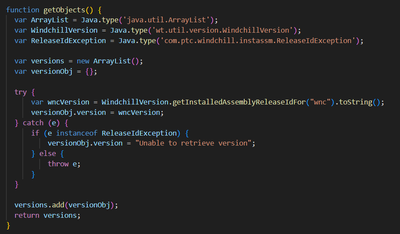

Hi @HelesicPetr
Thank you for your response. I have already ensured that my JS custom function imports the correct WindchillVersion class. Below is my js code :
I doubt this file does not contains the correct type !!

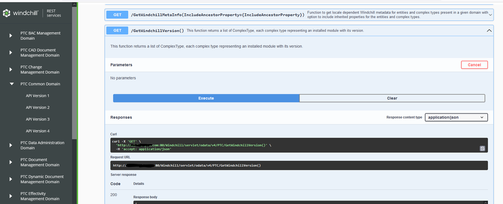

tarik_p
(To:BRAHIM)
There is an OOTB endpoint that outputs Windchill Version:
<hostname>Windchill/servlet/odata/v4/PTC/GetWindchillVersion()
tarik_p
(To:tarik_p)
@BRAHIM you are using JS Hooks in OData which has a different purpose, I didn't understand what you want to achieve!
