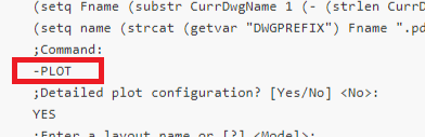

Seems the efforts finally paying off. The pdf is getting generated in the tmp folder however it comes with the suffix "-model".
Eg 56GF-Model.pdf , due to this the server is not able to pick the pdf file and generate representation.
If manually delete the suffix from pdf generated representation is getting generated.
The scr been used is attached.
Tried multiple ways still, suffix is getting generated.
Any suggestions on how to get rid of the suffix?
thanks in advance.
Durga

rhart
(To:DKWc)
You could try using ‘EXPORT’ in the scr instead of PLOT, export is like save as pdf rather than print a pdf, I used export for custom autocad workers and the pdf file name is the same as the drawing number + .pdf

rhart
(To:DKWc)
 Sure, see attached.
In our case, we export only the paperspace views to PDF,
DKWc
(To:rhart)
This script exactly worked for me.
Thanks HART you were popped in at exact right time.
This is working exactly as expected.
The publication is working fine.
