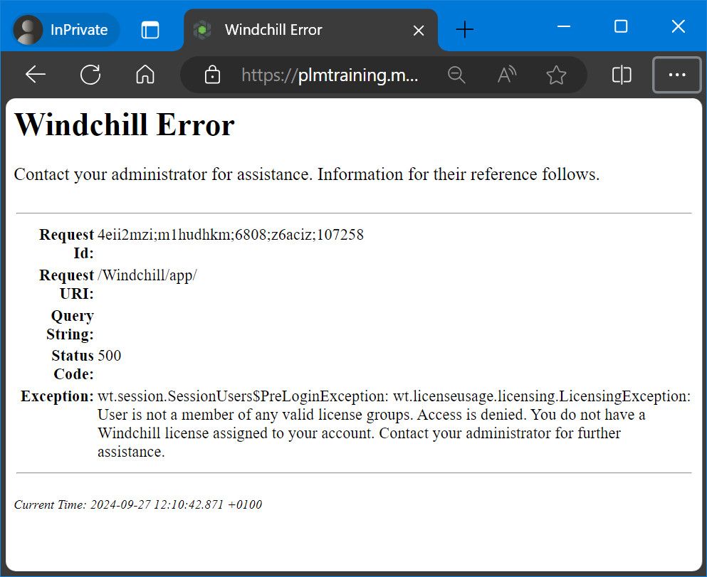

Customise the 'Contact your administrator for assistance' page
  • September 27, 2024
  • 708 views
Version: Windchill 12.1
Use Case: I'd like to add a link to our internal support portal on this page
Description:
Best answer by avillanueva
I believe the JSP you want to customize is here:
codebase/wtcore/error.jsp
Make sure you back up and manage properly your modifications.

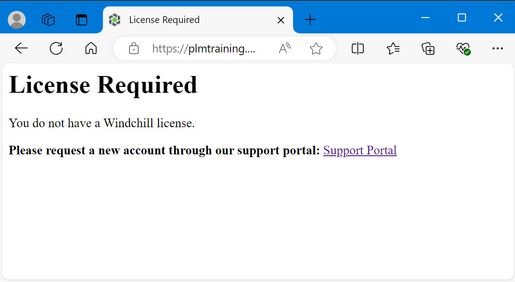

rhart16-PearlAuthor
September 27, 2024
Added an entry to codebase/WEB-INF/web.xml and restart
<!-- add it above any existing error-page entries in web.xml>
<error-page>
 <exception-type>wt.session.SessionUsers$PreLoginException</exception-type>
 <location>/wtcore/licensingError.jsp</location>
</error-page>
Created a new page (licensingError.jsp) to handle licensing issues
