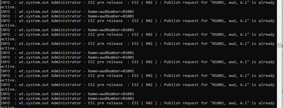

ESI ( 902 ) : Publish request for "01001, docName, A.1" is already active.
SU_10128205
6-Contributor
Error:  ESI pre release : ESI ( 902 ) : Publish request for "01001, docName, A.1" is already active.
Getting this error on Method server continuously.
how to resolve this issue.

Please provide a screenshot of the error that occurs.
Hi
Check that DOC is in PENDING,  PROCESSING state or not?
Looks , some Transaction is ACTIVE state..
regards
GAIN Sreeni
The most common reason for the error you reported is because there are multiple pending submissions of the object.
Normally you cannot perform a second submission of an object until the first one has been successfully completed.
If you want to check the status of the submission you can use a couple of reports that you can also find in this document.
https://www.ptc.com/it/support/article/CS58679
https://www.ptc.com/en/support/article/CS306400
Marco
