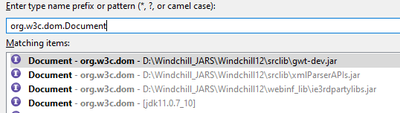

When trying to compile the Windchill Customizations (developed originally using JDK 8/Windchill 11) using JDK 11 (Windchill 12) we are getting compilation issues due to several packages being accessible from multiple modules.
For ex: org.w3c.dom package is now included in jdk11 jar by default (Module Path), but is also present in ie3rdpartylibs, xmlParserAPIs and dom4j jars (Class path).

The problem that I'm facing isn't that a package exists in multiple JARs. The conflict that I'm running into is where a package in one of the JARs is also included in the JDK distribution. For instance org.w3c.dom is in the WEB-INF/lib/ie3rdpartylibs.jar and is also provided in jdk11 (Corretto). I wasn't aware that there was a way to resolve this without removing that package from ie3rdpartylibs.jar. There are other packages in ie3rdpartylibs.jar that we need, so I need to leave that on my classpath.

PTC acknowledged and addressed this issue with a workaround in CS348994, https://www.ptc.com/en/support/article/CS348994?source=search
So, my intern and I just spent some time banging heads against the wall on this issue due to "org.xml.sax" package. We had import for SAXException in our code just for exception handling. The ant script that is downloadable from CS348994 does not resolve this conflict so needs modification. I guess the reason why PTC has not closed on a severe SPR was because they realized there was more work to do. In the end, we removed the reference to work around the issue but here is what I think needs to be done.
The conflict is in the ie3rdpartylibs.jar file and this package also exists in Amazon Corretto JDK 11. The exclusions section needs to have "org/xml/sax/**/*" added.
<target name="ie3rdparty" description="Creates/distributes Windchill eclipse JARs">
<jar destfile="${lib.dir}/ie3rdpartylibs.jar" zip64Mode="as-needed">
<zipfileset src="codebase/WEB-INF/lib/ie3rdpartylibs.jar" excludes="javax/xml/**/*,org/w3c/dom/**/*,META-INF/*.RSA,META-INF/*.SF"/>
</jar>
</target>
