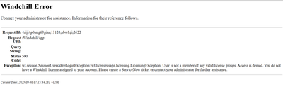

We are currently using Windchill version 13.0.2.2 in our organization. We've observed that some users are attempting to access Windchill without being assigned any valid licenses. In such cases, the error message displayed is overly technical and difficult for end users to understand.
To improve the user experience, we would like to customize the error page to display a simple and clear message indicating that the issue is due to missing Windchill licenses. I’ve attached a screenshot of the current error for reference.

That will change the error message you highlighted which seems very clear that you do not have a valid license. Are you also asking to change the rest of that page?
Yes. I am.
I want to remove all those details which are showing in the landing page.
My main request is that to change remove all the technical details and keep the page simple with only the content I need.

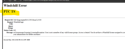

Hello Fedel,
Thanks a lot for the detailed message.
I want the page to display only the message stating that the user doesn't have a license and therefore cannot log in. All other details should be removed. Does the change you suggested help achieve that as well?
I have highlighted the contents that I need to hide from the error page.

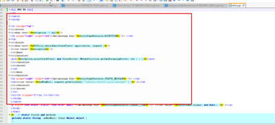

You have to customize codebase/wtcore/error.jsp

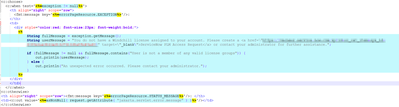

@Fadel I have updated the error.jsp to show the exception message as we need.
logic:
Result:
But my request is to understand if we have any possibility to show only the message to the users instead of all other results.
Can we customize the page itself only for the license exception errors?

in the jsp there is a html table keep only last rows  :
