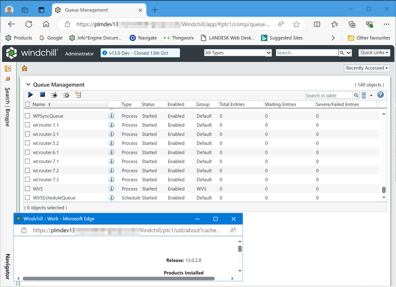

Dear all,
the requests to the OOTB and Custom OData Rest Endpoints are executed per default in the MethodServer context. We would like to implement a Custom Odata Rest Endpoint which should be executed in the Background Method Server Context, due to the concerns regarding the performance. Is there a way to configure \ customize the Odata Rest Endpoints such that they can be executed in the Background Method Server context?
We have a Cluster Configuration with Dedicated Cluster Master and LoadBalancer Hardware.

Windchill 13.0.2 ff support asynchronous requests following OData standard. I.e., for requests taken a longer processing time, an OData request can be submitted for background processing, the response will provide a URL which is to be used for polling for the result.
WRS uses Windchill Queues for asynchronous processing, in a new dedicated queue called WRSAsynchProcessingQueue. The dedicated Queue can be bound to a BackgroundMethodServer of your choice.

I don't see the new WRS queue in Windchill queue management, did I understand correctly?
MalteSiefkes
(To:rhart)
For help on this functionality please see https://support.ptc.com/help/windchill/r13.0.2.0/en/#page/Windchill_Help_Center/WCRESTFramework/WCCG_RESTAPIsODataAsynchRequestProcess.html.
The queue gets created dynamically during your first request.
