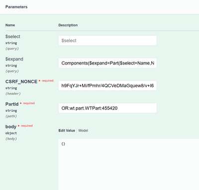

I am using Windchill PDMLink Release 12.1 and Datecode with CPS 12.1.1.0
Trying to fetch BOM data with ID e.g.OR:wt.part.WTPart:455420, in the WRS Domain under Product Management Domain under POST GetBOM i enter Parameters and CSRF TOKEN from /servlet/odata/PTC/GetCSRFToken()
the Parameters
Name Description
$select
string
(query)
$select
$expand
string
(query)
Components($expand=Part($select=Name,Number),PartUse,Occurrences;$levels=max)
CSRF_NONCE *
string
(header)
wq4/k91jTdavRJ8Olv9d34oJDJLcCNM5s4FQ37gbFbObF/hh+pgU+ocrf73iE647gcNW1vIIfeuVdag68ZsHq+1Te+6ZcKVD9MgO9q8Nda/VEKp9p5xwyqlUKJnnfMVHl95c9u87err1D9NMgMplqqsAcA==
PartId *
string
(path)
body *
object
(body)
Edit Value
Model
"navigationCriteriaId": ""
and click execute

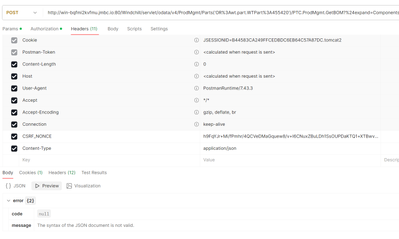

Here are the errors that I faced
when i paste the link in the POSTMAN I am getting error
"error": {
"code": null,
"message": "The syntax of the JSON document is not valid."
I will share the steps for postman:

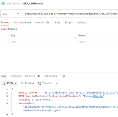

1, Get latest CSRF NONCE
URL: http://<server>:80/Windchill/servlet/odata/PTC/GetCSRFToken()
Request Type: GET
Only Authorization tab needed to be filled in Postman
Copy the Nonce Vale

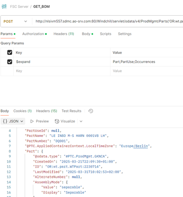

3. Exceute the Get BOM
URL: http://<server>:80/Windchill/servlet/odata/v4/ProdMgmt/Parts('OR:wt.part.WTPart:2230714')/PTC.ProdMgmt.GetBOM?$expand=Part,PartUse,Occurrences
Request Type: POST
Replace the Part ID in step 3 url as fecthed in step 2
Also, add a parameter as CSRF_NONCE with value as fetched in step 1 in the headers tab in Postman as shown below
Give the body as {} in the Body tab in Postman as shown below
Then execute the request to get the result.

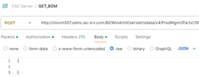

Is the Navigation Criteria even neccassary?
Remove Nav criteria and keep the body blank.
Try this URL:
https://<serverName>/Windchill/servlet/odata/v4/ProdMgmt/Parts('OR:wt.part.WTPart:455420')/PTC.ProdMgmt.GetBOM?$expand=Components($expand=Part,PartUse,Occurrences;$levels=max)
The Rest API PTC.ProdMgmt.GetBOM is deprecated and can only be used in REST v4
like this
cannot delete the exclamation
POSTMAN i get this
the issue remains, or did I type something wrong

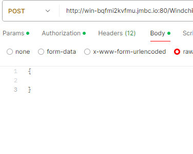

I accepted your reply as solution and in your proposal i've found my mistake
I forgot to put exclamation to Body tab
