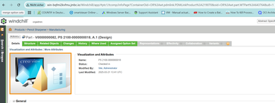

Hello community, In my case i want to fetch some data from my BOM (in the picture)

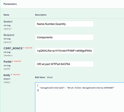

so i need to fill the parameters
I've used the PartID from the first picture in the URL, the CSRF NONCE i got from this Link http://<Windchill HOME>/Windchill/servlet/odata/PTC/GetCSRFToken()
and copied the code  in the CSRF_NONCE Field
i am not sure what to type in the body can I let it emty?

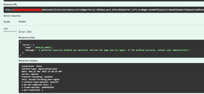

when I click Execute i get the Link with error code 400

Are you sure the part you queried has a BoM, I noticed the version is A.1

Please refer to https://community.ptc.com/t5/Windchill-Customization/Fetch-BOM-Data-from-WRS/m-p/1008616#M9744
If you have still have specific doubts, let me know.
