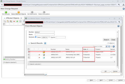

I've read that baseWhereClause can be used to filter objects in pickers.
https://www.ptc.com/en/support/article/CS25075?source=search
I added the clause to 'AddAffectedData' jsp in the server, but the UI is still returning objects in all states, the state.state = PRODUCTION filter is not being applied.
2 REPLIES 2
HelesicPetr
(To:RG_10753677)
Hi @RG_10753677
Does the change applied to the system?
I mean, have you delete Windchill cache , restart Windchill and clear browser cache after you applied this change?
PetrH
Yes, I deleted WC Cache, restarted the server and my browser session, but doesn't seem to help.
