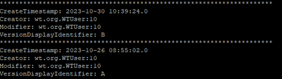

AB_9905442
(To:HelesicPetr)
Hello ,
Thank you for the methode , but it display only 2 iteration

HelesicPetr
(To:AB_9905442)
Hi @AB_9905442
And is it wrong? why? you didn't provide real data if there are just versions A.1 and B.1 the result is correct.

HelesicPetr
(To:AB_9905442)
Hi @AB_9905442
Obviously the method returns just latest versions of all revisions.
So you can use another method as a query definition

AB_9905442
(To:HelesicPetr)
@HelesicPetr  Thank you for the methode , its display all the documents
from this  can  i get  version , file name , state , comments ,modified by and last modified  as the picture ?
