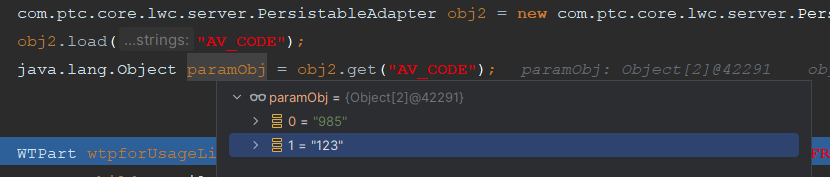

I don't know what you have done wrong but in my case it works.
The multivalue attribute returns an array of a string
PS> your catch (Exception wte)  can case that the parameters are empty because you don't know about the error that you can not cast the Array to a string 😄

smcvr
(To:HelesicPetr)
Hi @HelesicPetr
When I took the attribute value as an array, the code worked.
Thank you for your ideas 🙂
