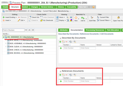

How linked MfgProcess and ReferenceDocument?
vkomyshenets
2-Explorer
How linked MfgProcess and ReferenceDocument? I can't find this relation

com.ptc.windchill.mpml.MPMDocumentReferenceLink
CompuGeek
(To:vkomyshenets)
Thank you. I now understand the full path. Unfortunately I am unable to find this relationship in the administrator [Manage Types] panel or the WTTYPEDEFINITIONMASTER. Without this connection, I am unable to view/understand the available/required relationship attributes.
Hello @vkomyshenets
You should go to the MFGProcessPlan structure and go to the Documentation.
There is a UI to link Process Plan or operation with reference document
This relation uses the com.ptc.windchill.mpml.MPMDocumentReferenceLink
