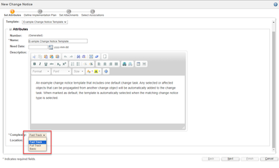

My 2 cents would be to not over complicate things. A revision is a revision is a revision. Just to be clear that we are not talking about FFF which should change part number.  I would and do handle this in the change process. I have a type of technical and non-technical change. They are all still revisions but you can work into the process that if its is a non-technical change (minor), it would not trigger those working with a supplier to do anything.
This could be handled with Complexity (already part of a change notice). Full track requires going through a Change Request Board on the Change Request, and A Change Implementation Board on the Change Notice process.

PTC Would have this covered with their Full Track, Fast Track and Basic Change Complexities.

I would recommend that if you are doing consulting and implementing Windchill for a "customer" that you might actually want to know/understand Windchill functionality. As I described earlier, OOTB Windchill allows you to designate a change as Full Track (Major/Class 1), Fast Track (Minor/Class 2), or Basic. If a normal end user is modifying objects via change notice, objects will need to be revised through a change notice task.

Fastrack and fulltrack is based on the complexity and CRB board right ? How this will help to get the user to revise on Major and Minor revisions? I would like to understand the revision with fulltrack and fasttrack?
Typically, changes that meet a specific threshold (cost, schedule, complexity, risk etc) would be categorized as a "Major" Change and would go through a review board for approval. This could happen for both a Change Request and a Change Notice. In Windchill, a Full Track change includes a Review task in both CR/CN to account for recording an approval authority vote on a change request or a change notice plan of work.

You can solve minor major by workflow as others describes. Fast/Full track you can change the words to minor/major and set the workflow as you need.
