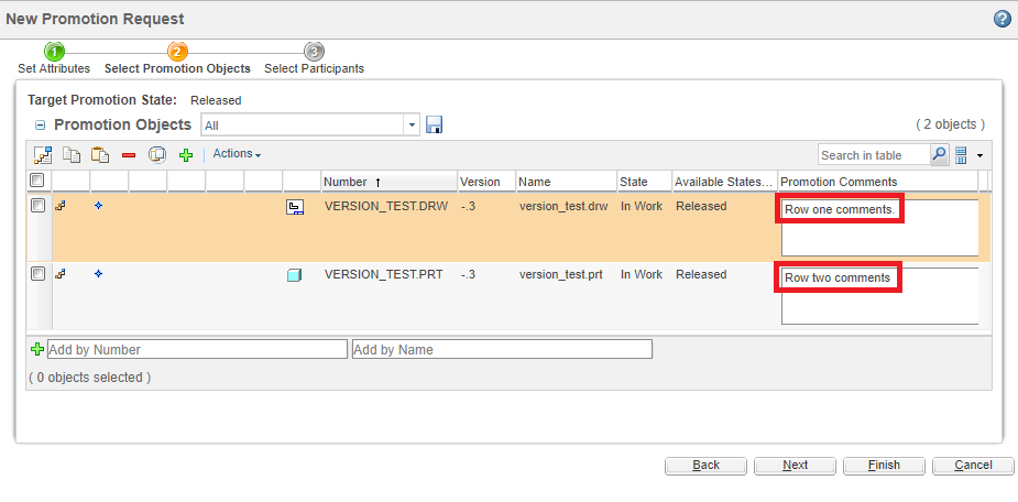

Does anyone know the syntax required to access the comments entered for each promotion object line on a promotion request?
I have the syntax necessary to loop through each object in the baseline, but these are the actual EPMDocuments and don't contain the comments that are part of the promotion request (as far as I can tell.)

What is the syntax necessary to get each row in the promotion request itself instead of just the objects on the baseline?

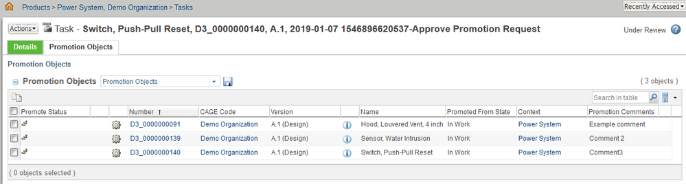

JeffZemsky
(To:TomU)
@TomU Have you thought about using the Promotion Objects table in your Workflow Layout?  It will show the Comments column.

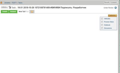

Hello, JeffZemskyplease tell me how you added Promotion Objects table in your Workflow Layout?
I tried to do that https://community.ptc.com/t5/Windchill/Where-to-write-the-code/td-p/630464 , but it didn't work.
That's what I did https://community.ptc.com/t5/Windchill/What-type-should-be-the-variable-obj/m-p/633206#M60480

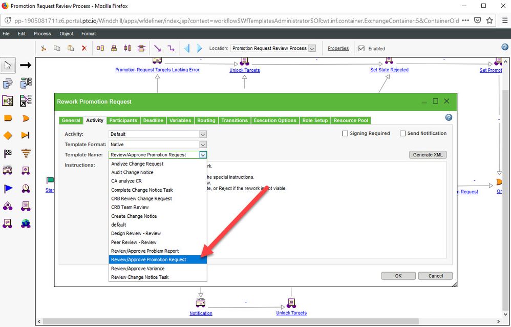

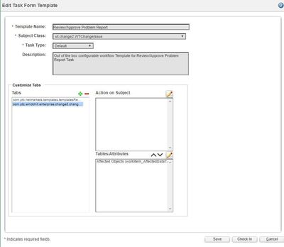

@VladiSlav it is purely through configuration.

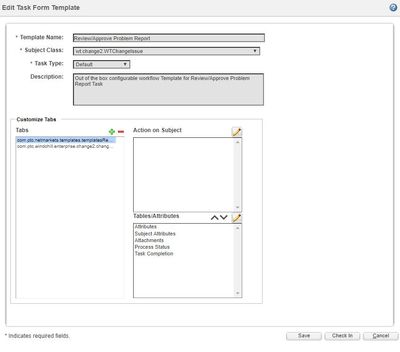

First you edit the Workflow Activity Templates -> Go to Templates and Task Form Templates.  There is an OOTB example in Review/Approve Promotion Request
You can configure the Workflow Activity by creating Tabs and then populating the Tabs with Actions and Tables/Attributes all through the UI
The final step is to set your workflow activity to use this template.  Note that once you do this any updates to your template are dynamic and show immediately in any running activity that uses the template.

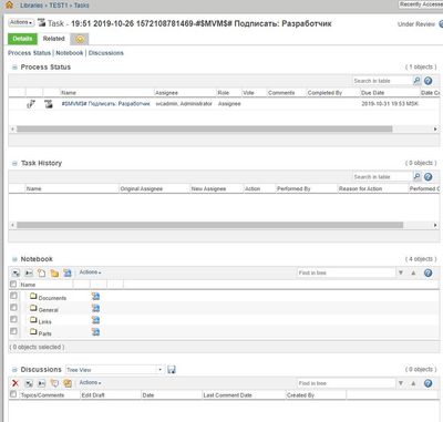

JeffZemsky, please specify, in the end it should turn out as You have in the screenshots? I opened the appropriate templates, but I have everything as you have

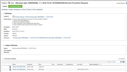

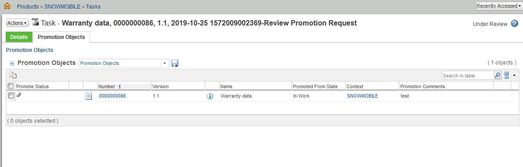

@VladiSlav Here are the two tabs you will see based upon that Task Template
JeffZemskymy page is different from yours. Or did I misunderstand you?
@VladiSlav What is on your Related Tab?
Also - my example is the OOTB workflow from 11.1 onwards.
Did you configure your table view on your Promotion Objects to show the Comments column?
JeffZemsky, I didn't set up the table view, I wanted to add the "Promotion Objects" table to the "Task" page":
https://community.ptc.com/t5/Windchill/How-to-add-the-Promotion-Objects-table-to-the-Tasks-page/td-p/627590
Tell me, please, with the help of Your example it is possible to implement it?
