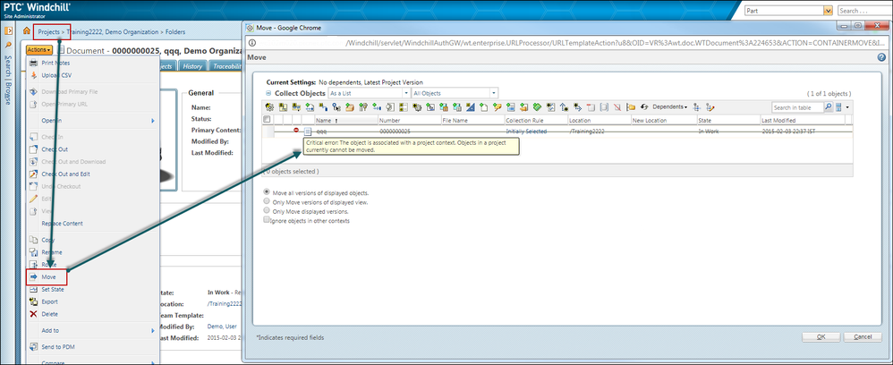

Hi All,
OOTB "Move" action is disabled in Project context. this action is hidden by "wt.dataops.conatinermove.processors.MoveValidator" . is any way to make it visible in projectlink context.

If the move action is disabled, it's for a good reason.
Check https://www.ptc.com/cs/help/windchill_hc/wc110_hc/index.jspx?id=CommonMoveRestrictionsRef&action=show
in detail :
  • Objects can only be moved to and from product and library contexts. Move is not available for projects or programs.
You cannot change this with custom code...

I dont know the coherence behind keeping this action hidden in Project however competely agree with Oliver and believe there must be some good reason (atleast after my below findings).
I am able to make move action enable in Project with my custom validator which extends OOTB "wt.dataops.conatinermove.processors.MoveValidator" validator, but it is of no use.
Note: This is again Unsupported class. So I would not encourage/recommends to do so...
On Move wizard, it has made so robust that Windchill again validates whether objects are from Projects and if so, it displays appropriate error as below:
So, I dont think it is that straight forward that I thought earlier.

Move has never been available in PJL, just like Revise. There are ways to expose both of them, but PTC strongly suggests to not use them since they are completely unsupported. If you really want to have a Move action in PJL, please vote up the following idea.

I had similar issues a while back. Project link is not intended to be used in that way that is why the functionality is disabled. PJL is a collaboration tool and isolates data from the products and libraries so it can be shared internally and externally without the source data being vulnerable to change or worse.
Create your data in products and libraries and share to PJL. Suppliers and other teams can edit and make changes but these don't flush back to the source until the project manager has authorised. The changes can also be rejected by PM.
Same condition for promotions and revisions do in product and libraries and share to project once items are promoted.
