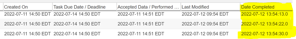

Do you know how to prevent the formatting from changing? In the image below you can see most of the data columns have the same formatting but the "Date Completed" column is different.
No, I don't know of a way to have those displays "normalized" in the generic, untouched, query builder report.  Honestly I don't even know why they're stored differently in the DB.  That's also an assumption - the fact they're stored differently.  Truth is, most of my interest regarding date/time stamps are only on the date itself for reporting purposes.  I typically only get into actual timestamps when I'm doing a forensic investigation of something that "went wrong" in a workflow process or something.

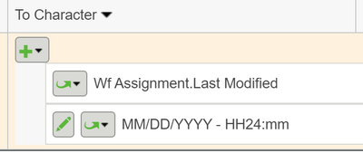

Another way to format the date in your report is to do the below:
You can use a - or / in the format as well.

@IanW, this is very helpful!
Do you have a link for "To Character" documentation that you can share?
I 'd would like to see how time zone or 24h time options are handled.
Thank you
Here is the link to where I found this solution.
https://www.ptc.com/en/support/article/CS139088?source=search
