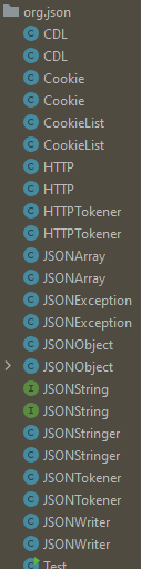

I am working on some Windchill customization for a client. I did a Java program, called as onpublish.afterloadermethod. I call some external REST web services and get back JSON response, which I have to parse.
As Java 8 doesn't have native JSON parser and I don't want to use third party Java JSON library (possible maintenance problems and additional work involved), I want to use some internal solution (like internal JSON library, used by developers), which must exist inside Windchill and will be available with future WIndchill verisons.
Can anybody help me?
Thanks.

Hi @TomazJeras
Windchill library contains a json.jar library file in <WTHOME>\codebase\lib\json.jar
the jar contains all what you needs to manipulate with a json format.
package org.json
hope this can help;
PS> sure there are others packages
<WTHOME>\srclib\json-smart.jar
<WTHOME>\srclib\json-simple.jar

Thanks a lot!
The jackson jars contain json related classes also:
[root@wc srclib]# jar tvf jackson-core.jar | grep -i json
