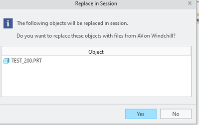

Hi @YJ_10068754
Yes, user has to use synchronize function in the workspace.
This function updates the attributes in the local workspace and allows user to update Creo session.
Yes user has to do it manually.
